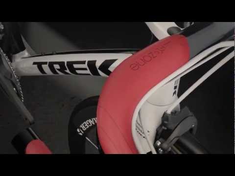

Trek focused on how the body vibrated while on the bicycle, what they found was that different parts of the body vibrated at different frequencies. For instance, your eye vibrates at 30 to 60 hertz, while your hands vibrate at just 20 hertz. They developed IsoSpeed as a way to take the energy that goes into a frame, or into the bicycle at the axle and dissipate it without actually going straight into your body. By allowing the seat tube to flex and also isolate the flex from the frame, you’re not affecting any of the handling characteristics, but you’re able to double the compliance of the bike. A rider would in theory be able to hit a bump the same size and feel half as bad as they would have had they been on a bike without IsoSpeed. How Trek was able to do this is with a smart new junction point at the seat cluster. It’s no longer a rigid fixed point, but integrates a de-coupler, with a pair of sealed bearings, that isolates the movement of the seat tube from the rest of the frame. Freeing the seat tube to absorb more forces from the road, the Domane is able to achieve more vertical compliance, Trek claims up to double that of its competitors. The frame with the with the addition of the IsoSpeed sealed system is still only 1050grams for a 56cm frame.
