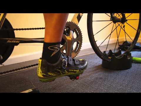

Video: Demonstration of click in and out action of the S-Track Pedals
The S-Track was designed to have a very reliable, consistent and positive click in and out mechanism. And at the end of the day, that is the ultimate test of a clipless pedal. How is the clip in and out action of the pedal? How easy is it to find the pedal and click in? How consistent is it when clicking out? We rate the S-Track the highest in all these categories. The spring is tight and positive and it gives a very audible click when clipping in and out. The cleat is made of a very hard metal to give it that positive feel and maintain durability over the years. Yet, they were able to merge rubber material to it to improve the mating with the pedal.
The pedal spring tension is not adjustable but it seems to be set just right for experienced riders. There is +- 3 degrees of float and it takes 15 degrees of rotation to click out. There are shims provide with the pedals to achieve the perfect mating with the shoe sole. The sole does not need to contact the pedal body but riders who want the maximum power transfer and comfort can play with the shims to ensure that the shoe sole and the pedal body contact perfectly when the shoe is clicked in.
