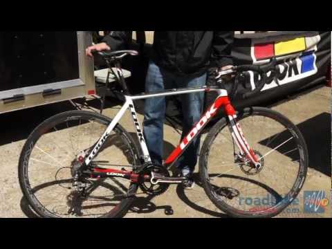

Justin giving us a quick overview of the X-85
