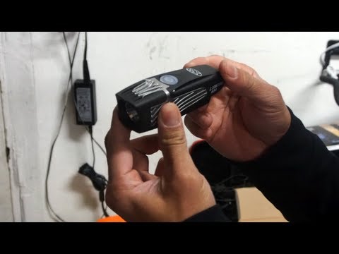

You don’t have to limit yourself to just blinkers to be seen either. The “To see” lights are lights that will not only help you be seen on your bike, but will also help you see the road that much better. These lights feature LED bulbs, better light patterns, and often come with internal lithium ion rechargeable batteries to keep the high powered LEDs happy.
These lights though a little more expensive are worth the investment if you find yourself riding in the dark a lot. If you have access to USB ports at work, they’ll also be easily recharged. LED power can range from 120 lumens up to past 1200 lumens depending on model. (For reference, the auto industry standard for a single low beam head light is 1200 lumens.)
